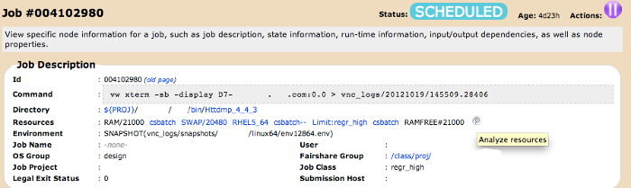

Why is my job not running?
There can be many reasons why your job is not running. The simplest reason is there a typographical error in your code. For example:
In this example, the space after the second csbatch was omitted, resulting in the nonexistent tool "csbatch--". Because csbatch does not exist, the job will not run.
