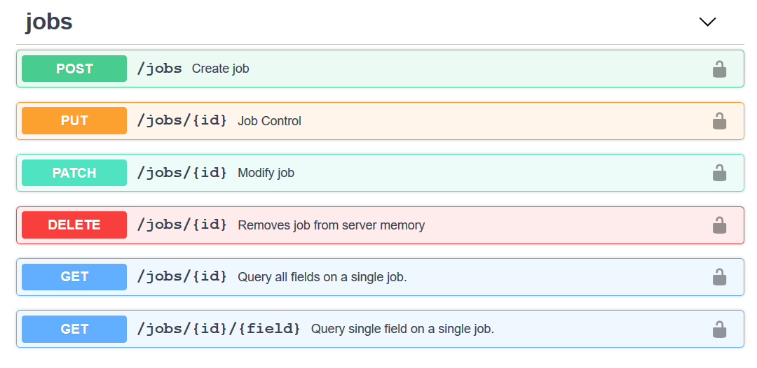

The Accelerator REST v3 API interface is described in detail under the Swagger documentation that comes with the Accelerator software. To browse the Swagger REST documentation, browse to the URL displayed as the output of this command:
nc cmd vovbrowser -url /html/vovrest.html
The information at this page will help you construct a valid REST request.
For example, browse on the Swagger documentation page to the “jobs” object. You will see that a POST request is used, and the REST URL segment is “/api/v3/jobs”.
Click on the POST button for more details about the required and supported dictionary keys and values for the request. This gives you what you need to know to construct a complete and working job submit request using the VOVRest package Python functions
