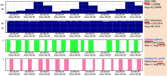

Job Profiling
When job profiling is activated, Accelerator tracks memory usage, CPU usage and license usage over the lifetime of a job.
The output of job profiling is a set of plots as shown below:
The first plot from the top shows the RAM usage over time. The second plot shows CPU usage over time. The third plot shows usage for licenses that were requested at submission time. The fourth plot show usage of a license that was not requested ("Requested/Used")
To activate profiling on a single job, use the option -profile of nc run as shown below:
% nc run -profile myJob
To view a profile, use the browser interface and visit the specific page for the job.
