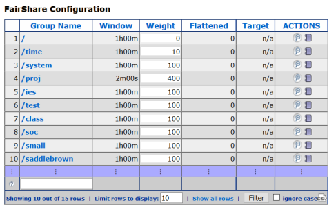

Set FairShare Weights Via the Web Interface
As of the 2017 release, Accelerator Admins are now able to change the FairShare group weights from the browser. The weights can either be changed by using the +/- buttons on the right, which changes the weight by 10%, or the weight can simply be entered under the weight column. As with many configurations in Accelerator, the changing of weights is only permitted by Accelerator Admins.
Of course, vovfsgroup can also be used to change the FairShare weights at any time.
