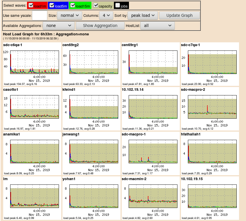

Tasker Load Reports
vovtasker continuously logs 1 minute, 5 minute and 10 minute load averages of the machine where the tasker is running. Tasker load reports are available on the Tasker Load page.

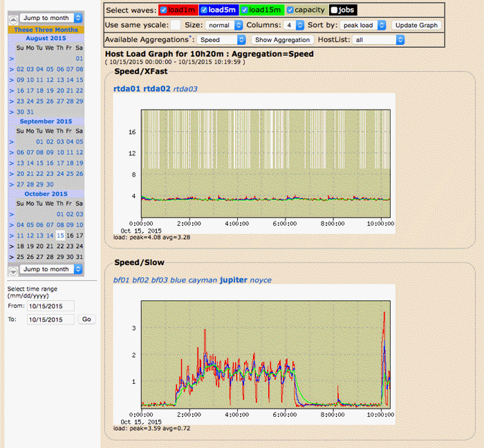

Setting up Aggregation by Speed
Two categories of Speed
are available: Fast
and
Slow
. The Fast
category includes machine
farm01, farm02 farm04 farm07 and farm08. The Slow
category includes
machine farm12, farm13 and farm14. In this case, choosing to have the report
aggregated by Speed
will result in two plots: one plot with the sum
of the load of the machines defined in Fast
category; one plot with
the sum of the loads of the Slow
machines.
Speed
